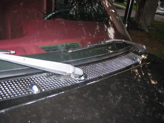

The wiring is a bitch man I can't find a good conection, so tomorrow I'll get em lighted hopefully.

Heh I was very suprised I didn't get too bad of a comment..
Well it told us to wire it directly to the parking lamp fuse and we're having a helluva time to get the damn thing to work. It will work if we wire it right to the battery but then it would stay on all the time. The problem we're having is we spliced the white to white and black to black together so its just 2 wires and not 4 that have to go to the fuse. All it is is we just have to find a good connection because...well we have bad splices lol. We worked too hard getting the damn things in the cowl so we ran out of steam to do anything else right haha, plus we're electricaly challenged people.

Run both grounds (black) to the firewall. There should be plenty of little gorund wires attached there to use. Run both positives (white) to the power wire AT one of the parking lights and use a Scotchlock connector. The entire job should take no more than 20 minutes, no holes in the firewall and no trash wires under the dash. If you're really a good boy, I'll tell you how to make them flash with the turn signals.

We actually have a small hole in the firewall right to the left of the clutch pedal that has a rubber plug with a hole in it to run wires through. The rubber plug didn't have a hole so I drilled a tiny one in it when I was installing the fog light switch. We have a Scotchlock connector too so thats one thing to mark off. I'll try it tomorrow thanks Hobo. Now, how would we wire it to the turn signals? Thats unique
