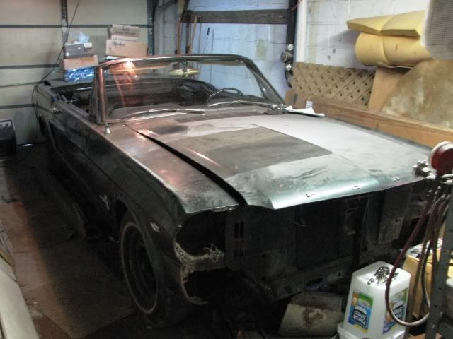

A little update:
Got her in the garage in early December, so I have been able to get some work done. Conv. top is off, fenders and hood are off, radiator is out, exhaust has been removed, working on taking the glass out.
Got a cart for the engine to go on, so once I can make arrangements to borrow an engine hoist, and I get a free weekend, the engine and trans will be pulled out.
There has been a slight change in plans: So far it looks like I won't be building a jig, but rather I'm leaning toward using an assortment of jacks and stands to hold things in shape while I work on the rockers and frame. And it looks like most of the suspenssion will be staying in for ease of menuverability. As you can see, there isn't much room in the garage, so I will need to be able to roll it out to the driveway.

sounds like things are moving in the right direction. And jack stand will work great to hold things in place while you work. On convertible we typically use 8: 2 at the very front under the frame rails, 2 near the torque boxes under the front frame rail, 2 at the rear torque box near where the leaf springs mount, and the last two at the rear under the frame rails.... It will be just fine as long as you take your time jacking it up. Only go a little at the time, do not jack the front all the way up and then jack the back all the way up. Do it in about 3-4 stages. If that makes sense.
Good luck and remember to take your time. In the end you will be glad you did.
